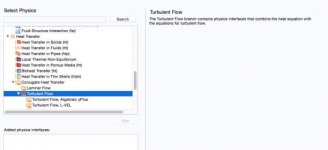

انتخاب نوع مد کاربری: CFD software
دوم: برای دما باید از این قسمت استفاده کنید:
  • Fluid Flow and Heat Transfer: The CFD Module includes a Conjugate Heat Transfer interface for describing fully coupled heat transfer in solids and fluids, including laminar and turbulent fluid flow. By default, this solves for nonisothermal flow and can be coupled to any other physics interface that includes temperature, such as interfaces for surface-to-surface radiation in the Heat Transfer Module, Joule heating, and heat of reactions in Chemical Species Transport interfaces. In addition, physics interfaces for heat transfer in porous media combine the conduction in the solid matrix to the conduction and convection in the fluid phase while accounting for the tortuous path taken by the fluid, and the heat dispersion this entails.

جواب:
برید این قسمت:
