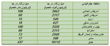

بررسی ذخائر گاز شیل در جهان

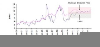

US success in tight/shale gas means US-bound LNG can now be diverted to Europe. Can costly Unconventional resources compete with LNG in Europe?
Gas Spot Prices
