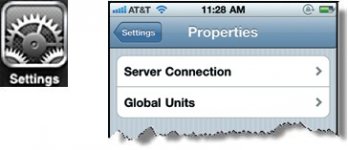

Configuring Default Settings
After installing the Aspen Properties Mobile application on your mobile
device, you can configure the default options through the Apple Settings
application. Go into Settings, scroll down to the Aspen icon labeled Properties, and tap the icon or label to open the
configuration screen.
Go to the Server Connection screen to enter the IP address, user ID, and password for your Property Server account
provided by your Aspen Properties administrator.
You can also configure the default units of measure within the settings. Go to the Global Units screen to select the base
units set (SI, Metric, or English). You can also override the default units for any of the physical types. These global settings
will be applied to any new property case you open.
