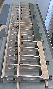

Ribs are made out of wood, metal, plastic, composites, foam. The wings of kites[1], hang gliders [2], paragliders [3], powered kites [4], powered hang gliders, ultralights, windmills [5] are aircraft that have versions that use ribs to form the wing shape.

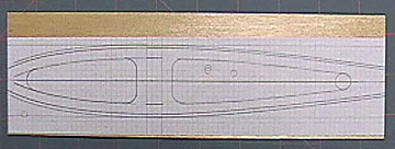

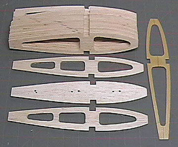

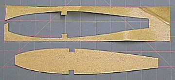

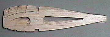

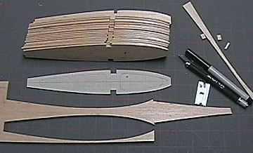

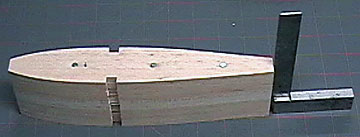

For full size and flying model aircraft wing structures that are usually made of wood, ribs can either be in one piece (forming the airfoil at that rib's "station" in the wing), or be in a three-piece format, with the rib web being the part that the one-piece rib consisted of, with capstrips for the upper and lower edging of the rib, running from the leading edge to the trailing edge, being the other two component parts.
